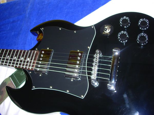

it's finally working! in the end i got my dad's pal to come round and solder the pups in, took him all of five minutes to do what i hadn't managed in two days :P
then i had to 'adjust' the pickguard a bit ( read: butcher ) since Epi didn't make the holes big enough to accomodate covers. then the screws were too long, so i had to hacksaw them.
here it is though!
sounds much better. highs are less abrasive, lows are less muddy. the clean sounds are more usable now. if only i could play the thing well  :lol:

« Reply #8 on: April 10, 2005, 09:36:19 PM »
Well done, looks great 8) !
