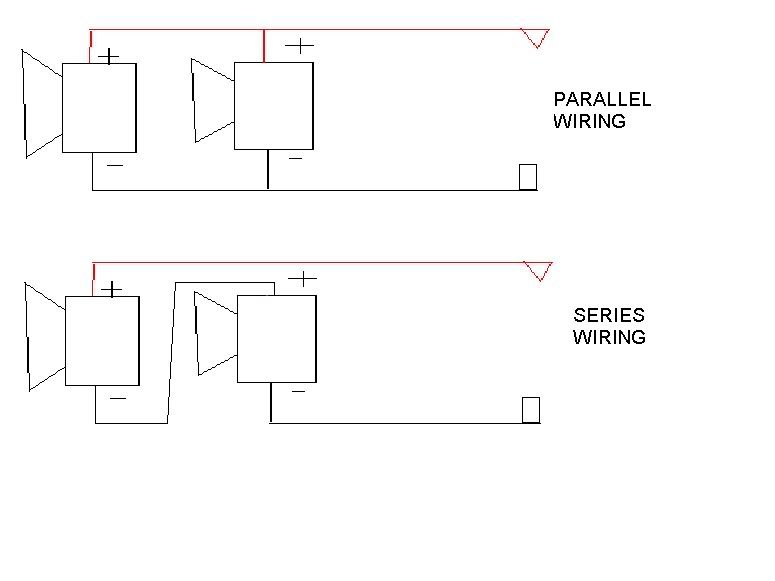

if you are after a 2x12 cab you either need to wire the speakers in series  or parallel.  (see the links i posted for an explaination)
when you wire speakers in series you need to add the ohm rating together so to get 8 ohms you would need two 4 ohm speakers.
when wiring two sepakers in parallel the ohms end up about half.  so two 8 ohm speakers will give you 4 ohms, or two 16 ohm speakers will give you 8 ohms
any of these combinations will work for you amp by the sound of it
really its just important that you buy two speakers that will be able to give you either 4 or 8 ohms when wired togther and the speakers also need to be able to handle the maximum output of the amp - i.e. if its a 50w amp you want the speakers to be able to handle more than that
building a cab
« Reply #6 on: June 28, 2007, 01:06:05 PM »
heres a quick basic diagram for 2 speakers either wired series or parallel
