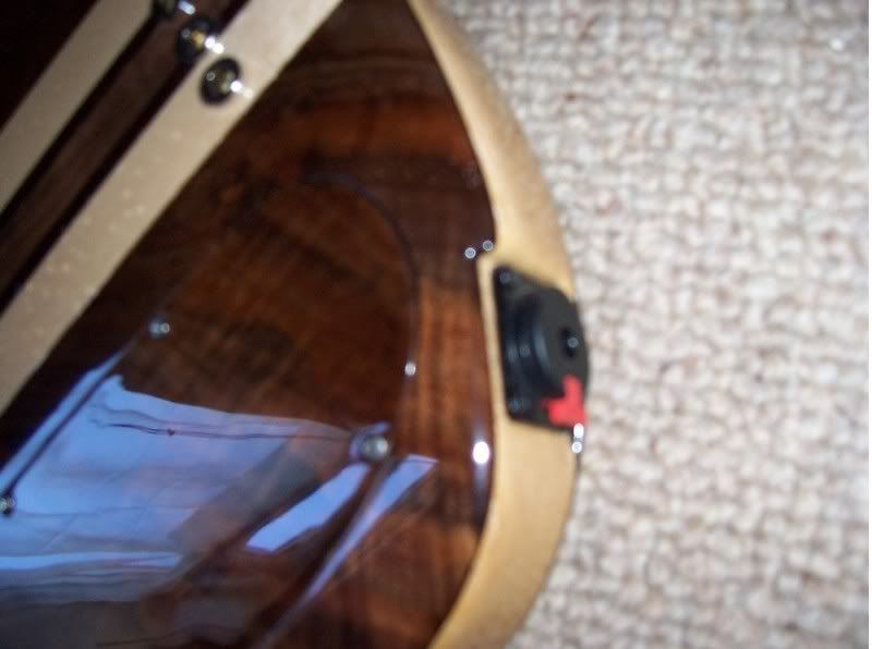

I have used the locking ones with the red button on a few guitars, stopped using them because they stick out too much for my tastes and even people who know hot to use them pull funny faces when removing the jack - that tells me they are unneccisary.
I solved the sticking out thing on a recent bass by recessing it:
But that creates the problem of a thin bit of wood on the front - which is obviously a weak spot - but the jack was a client request so had to be incorporated.

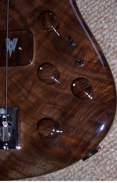

I suppose i should show the rest of the bass now - i rather like this thing.

That pinstripe is GORGEOUS!
So you say they're pretty useless?
I allways wondered - Surely if you trip or catch the lead of something it's better that the lead falls out than the jack being pulled out of the wood?
Set Neck / Bolt on
« Reply #14 on: July 12, 2007, 07:30:41 PM »
not useless - just completely unneccisary.
I agree that its probably better if the jack pulls out when stepped on rather than rip out all the jack socket with it - and suddenly it takes two hands to safely remove your jack which increases the likelyhood of you dropping the guitar
