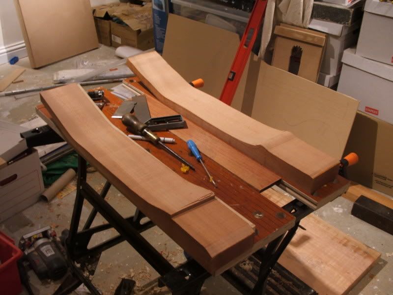

A pair of one piece Mahogany neck blanks rough-cut out on the bandsaw:

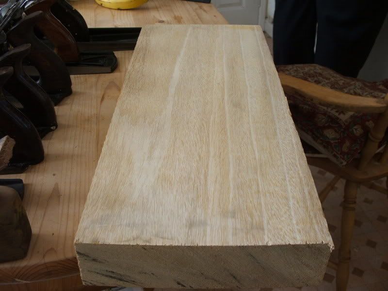

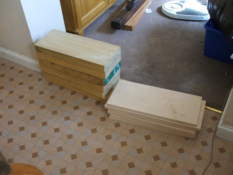

Here's the Maple and Korina as they arrived. The Korina is light and resonant, thanks Jonathan (Feline) for the tip. I think I've found the perfect timber - it cuts like butter, planes incredibly fast and easily (it took under a minute to go from rough to properly surfaced as seen in the pic), sounds great, weighs less than Alder and looks great too. The maple was surfaced before I bought it, which should save a lot of time.
3 Les Paul body/top's worth of timber there, which amounted to exactly £100 inc. delivery.

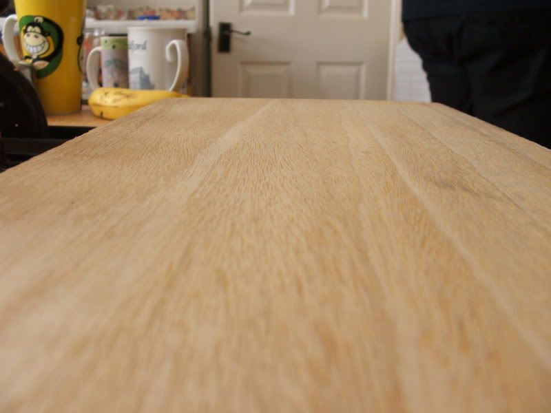

Clamping up and gluing the two pieces of Korina for the back:
Perfect joint with invisible seam - hard as hell to do with a hand plane if you've never tried it before, but it looks the business and is necessary when using hide glue:

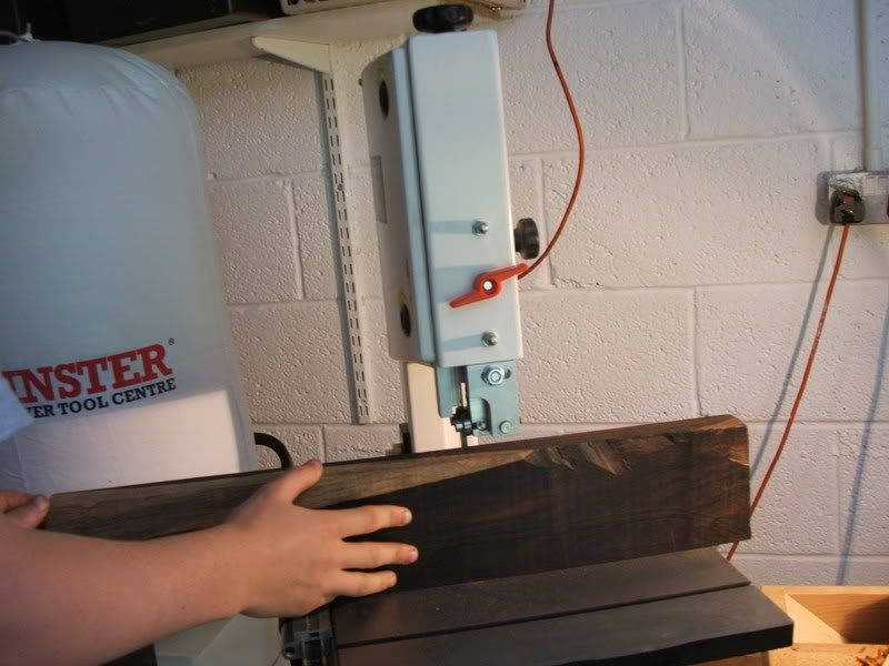

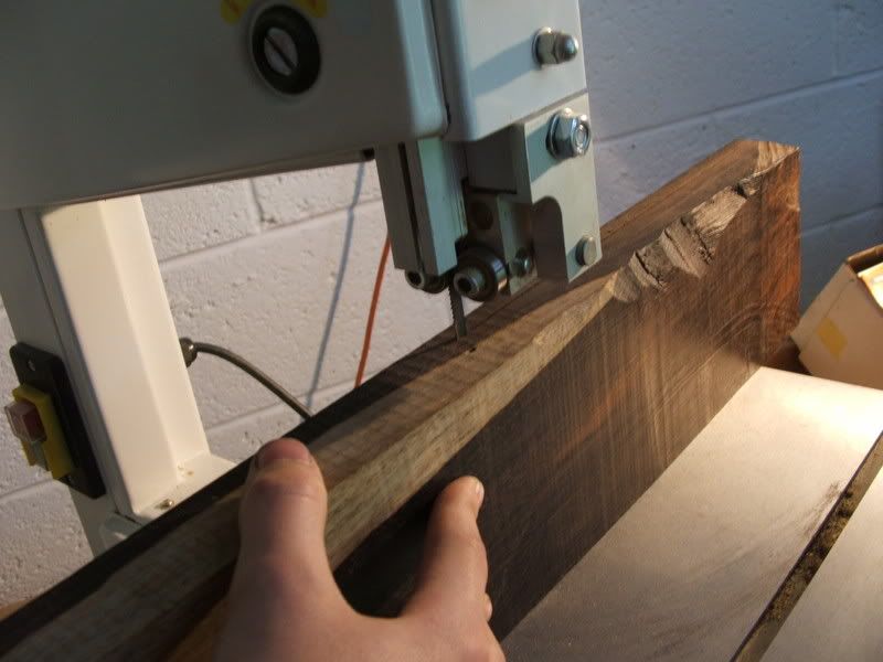

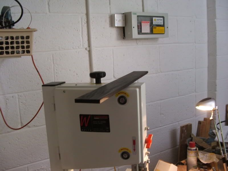

Bandsawing out the fretboard blank from a block of old growth Brazilian Rosewood:
Sawing the fretboard to width. The offcut will be used for making the soles of some carving planes:
Brazilian Rosewood fretboard blank, ready to be thicknessed:

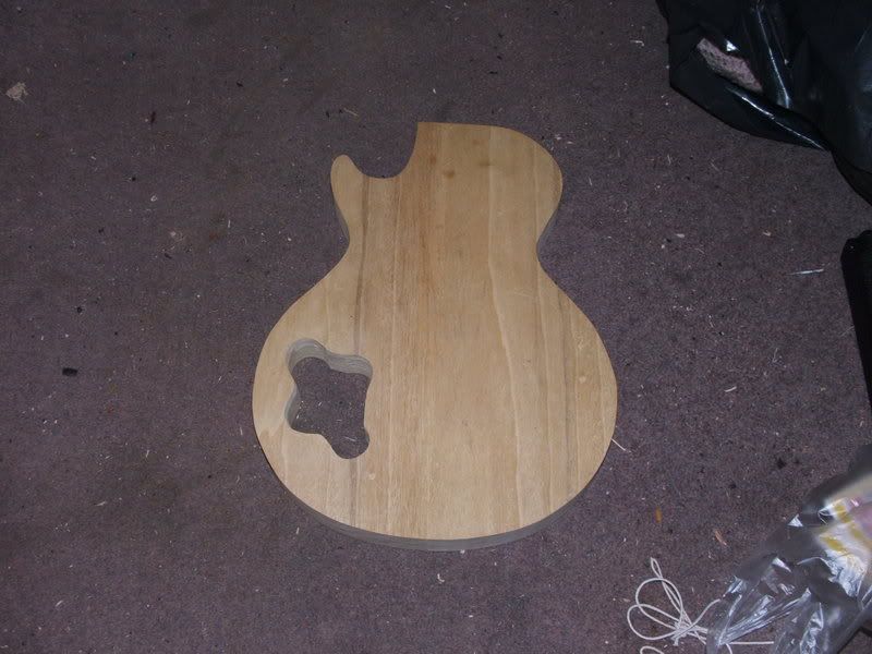

Rear view of the (almost) finished back section:

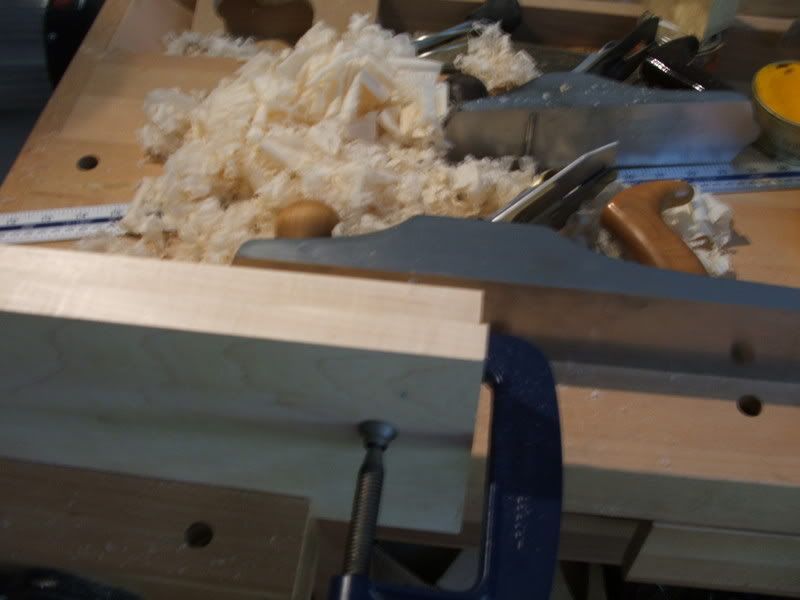

Did some work joining the maple top for guitar #2, the friend I'm building it for didn't want hide glue so this one is with the more forgiving titebond. I still work to the tolerances I use for perfect invisible hide glue joints though, as it's good form and also good practice for hide glue joints.
Two of the faces were flattened, and clamped together so I could plane the join.
The shavings from this maple are whiter than white!

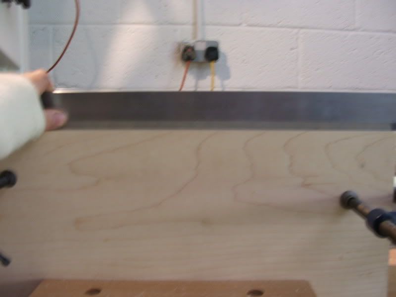

Before putting the pieces together and up to the light, I checked them with a straightedge too lengthways and widthways. If these show no light, then putting the pieces together shouldn't either.
