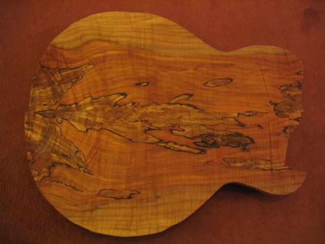

We are doing a guitar like that with a spalted maple top but its a real slowburning project.  I am teaching my sprayer how to build guitars but i have given him quite alot to spray recently so it hasnt progressed much recently
here it is rough cut out:
i think since then he has trimmed the top back and done some koa binding, we made a neck for it but it went wrong so need to do another - just as i was letting him do a bit more by himself :wink:
