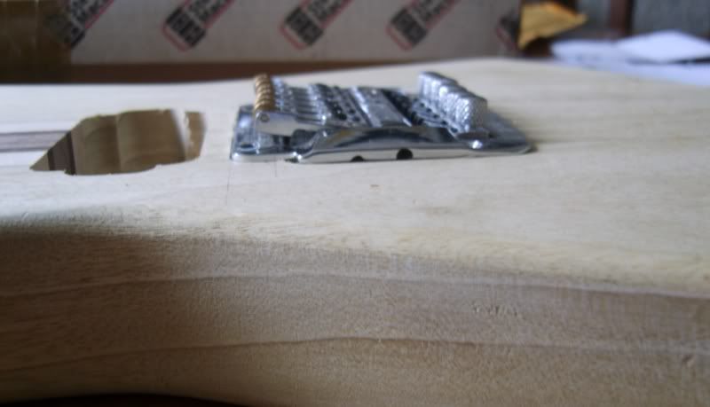

I put a recessed Kahler in my Ibanez bitsa.  It was set up originally for the Ibanez lo-pro but they are expensive and I picked up a Kahler flyer for $50 on eBay,  When I was looking at how to fit it to the Ibanez body it just seemed like recessing it would look best so that's what I did.  The string angle with the Warmoth neck worked out great.
Wez venables guitar build - Done and dusted!!
« Reply #423 on: September 21, 2007, 03:31:31 PM »
i will get a photo of this bridge from the side at some point - when you see it recessed it definately makes perfect sense, even if it meant i had to make an extra template :wink:
« Reply #424 on: September 21, 2007, 04:17:03 PM »

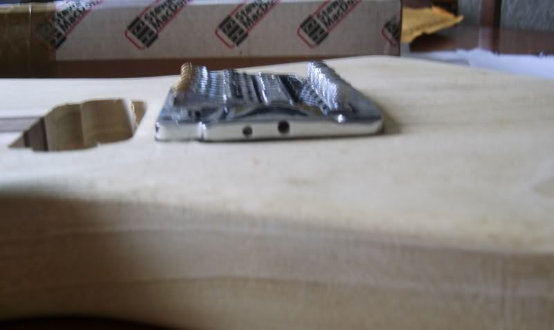

ok, as discussed before kahlers work with the strings being attached to a cam and then going over saddles which nver move whilst playing so you can palm mute to your hearts content without going out of tune.  Problem is that the saddles need to be raised to a certain height so you dont loose all tension on them when using the trem - this is where a lot of people go wrong with kahlers because the bridge design lets you lower the saddles past the point where they will function correctly.  Why they cant just thicken the base plate under the saddles so the lowest position was a functional one is beyond me.
Here is mine from the side, the saddles are set at there lowest usuable point  to maintain a good break angle when using the trem and the whole unit is recessed into the body - its currently set so the string would touch the fretboard because thats the theoretical lowest point i will ever need
I could have gone about it different ways but you cant deny these bridges are bulky buggers.  here is what it would look like if i didnt recess it
On a smaller sized exlorer like this i think it looks a little daft.
the only compromise is that now the little allen key that lets me lock the trem is not accessible so i will need to add a small channel behing the bridge to solve that

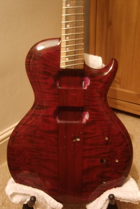

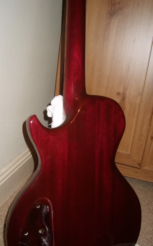

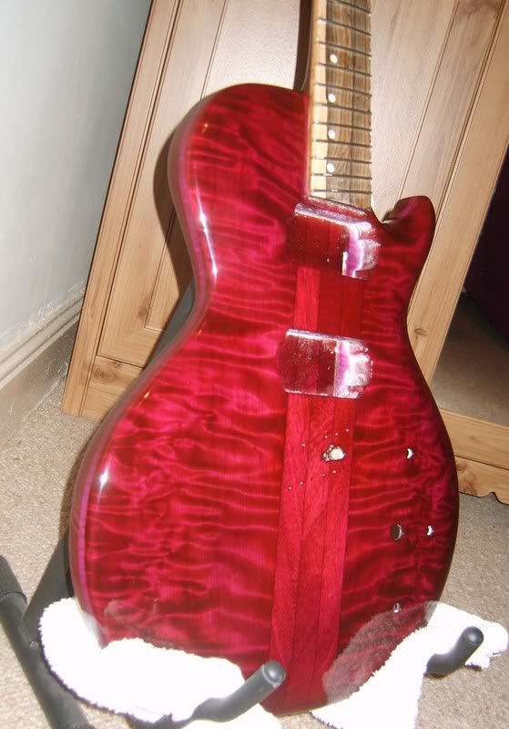

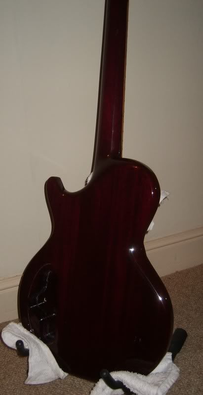

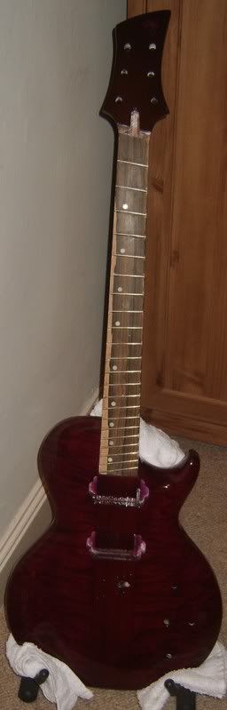

Anyway, got this back from the sprayer today:
Brightly lit so not like its real color but look at the reflections from the flannel:
this is closer to the real life colour:

« Reply #432 on: September 23, 2007, 10:13:19 PM »
Very nice!
Is the whole on the top by the bridge going to be visible with the bridge on?
Oli
  • Posts: 915
« Reply #433 on: September 23, 2007, 10:13:55 PM »
Veeeery nice :) That's how i'm going to do my neck-through; with capped body, but not covering the laminations. Quite the shiny finish on her :) Big fan of sapwood in the fretboard, nearly bought a few bits of cocobolo like that a few weeks ago, but decided against it; got enough fretboard wood already!
Looks like a really comfortable fan there- what bridge is going on it, individual saddles?
« Reply #434 on: September 23, 2007, 10:21:17 PM »
Yeah, individual bridges mounted on a ziracote plate.  The earth wire hole is slightly larger than normal to accomodate a wire from each bridge.  The actually channel is normal size - just enlarged at surface so i can join 6 wires into 1.... it wont be visible at all!!
This thing is all about comfort, its just over 1 1/2" thick, fully contoured and weighs practically nothing at the moment.  Its only a 1" fan from 25" to 26" with the 7th fret parallel... I just wanted enough to tighten up the low e when down tuning.
the neck is all reclaimed mahogany.  the body wings  are mahogany, a thin bit of flamed maple and the quilted redwood on top.  I have the neck showing on the front because i got the redwood very cheap and it was never going to be good for anything other than a neckthrough
