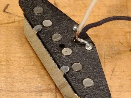

There's usually some kind of connection between (a) the point where the ground wire is connected to the pickup and (b) one of the little tabs holding the cover on.  I don't have any BKP Tele pickups, but it should look something like this:
In the picture the silvery-looking wire is going right through the eyelet on the pickup then connecting to the tab on the cover.  So all you'd need to do is carefully snip that wire near the eyelet, then desolder the bit still connected to the cover.  Then solder a third wire to that same point on the cover.
