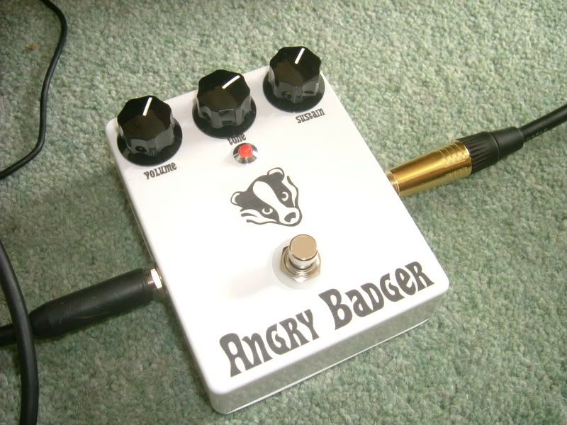

Mr Ed
  • Posts: 1128
  • Posts: 4713
Painting effects pedals?!
« Reply #6 on: October 19, 2007, 01:47:36 PM »
awesome!
