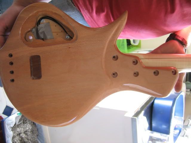

Well, during the build of the fanned-fret 7, i bought some bits and pieces, including an 8 string bridge. A few weeks ago i started to crack on with building the guitar, and i've been making some speedy progress:
Less than a week ago, this was the state of play:
And today this is how it looks:
I'm really happy with how it's coming along, i feel it's of much better quality than the 7 (which isn't bad :)). The neck needs a little more work on the heel, and a final look at the carve of it, but it's pretty much there. The fretboard needs to be radiused still, and i haven't decided on the inlays yet, so there's that to do. Next up is to mount the bridge, and draw up the control cavity. Pickup cavities will be routed when i can afford to get a pickup for it, but i'm unsure of which pickup (bareknuckle or otherwise) i'll be getting yet. The body will have come carving for the arm and the gut-cut, but that's the general body shape :)
A final photo of the neck join- using ferrules and bolts instead of screws and a plate. you can see where i need to recede the carve of the neck a little to blend in with the body:

Very nice.  The body construction looks more like a bass than guitar, is there some reason for this choice?  Does it have more sustain this way, especially on the 7th and 8th strings?

oppro: i came up with the shape because i really like the look of single cuts, and you tend to see them mostly on basses unfortunately, so i thought that because an 8 string is getting near bass territory, that it'd be appropriate :) Sustain should be good, as i'm really happy with the neck join- even without the bolts, it's a very good, snug fit... time will tell though, but i'm hopeful at the moment.

i like it a lot so far, i really like the singlecut bass styling.  if i was to criticize the shape i think i would make it a bit slimmer in the waist - but i like them curvy
i think access will be fine but i would consider reworking some of the heel a bit - you say there is wood to remove anyway
here was my first bolt-on singlecut:
i basically went for the 4 standard bolts at the end with an extra couple on the extension for support and tried to keep it as far over the bass side as possible - makes a nice thumbrest
i would consider tapering your heel section if you have room

Looks great, especially the neck. It's hard to tell from pics, but I think the horn could be a problem. You'd probably need to sculpt the back of it so it doesn't get in the way of your hand.

From my initial feel of it, it's a little tight, but i was planning on carving out the inside of the horn a little more anyway.... i don't think this guitar will be primarily a lead instument anyway! ;)
