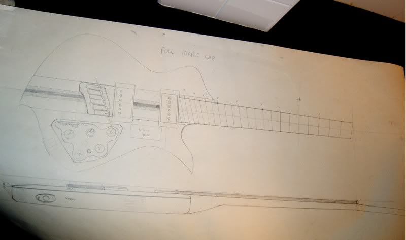

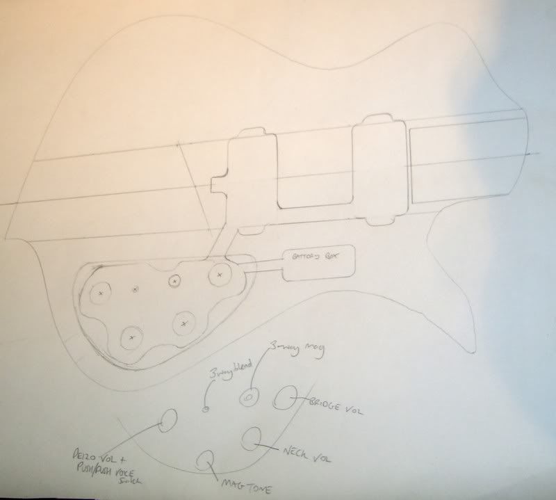

here is the drawings and materials:
http://i36.photobucket.com/albums/e31/WezV/new/plan1.jpg
http://i36.photobucket.com/albums/e31/WezV/new/routeplan.jpg

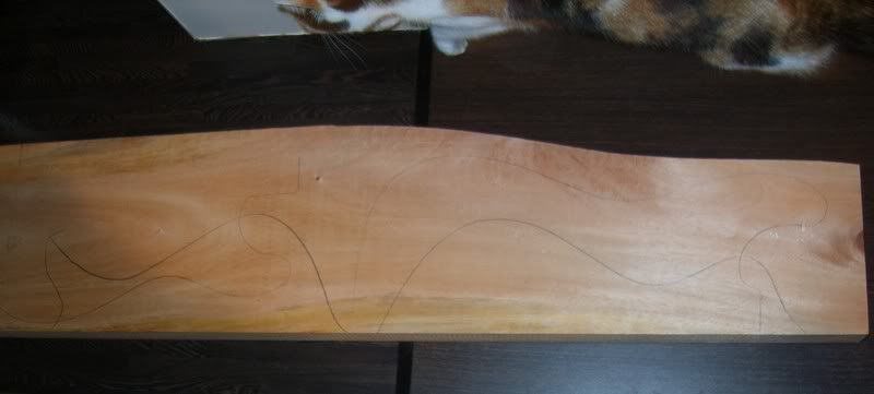

http://i36.photobucket.com/albums/e31/WezV/new/mahog1.jpg
http://i36.photobucket.com/albums/e31/WezV/new/neckwood2.jpg
the top wet down to show figure

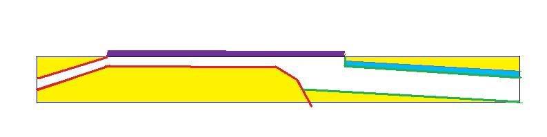

Wez, can I ask a dumb question about the neck through thing?
Do you stick the wings on flush with the top, or with the bottom?
Gut says bottom to bring the fingerboard closer to the strings...
Mark.
Re: Denim Blue + Multiscale build thread?
« Reply #5 on: February 27, 2009, 12:40:28 PM »
its going to have a bit of a neck angle so currently the body section is waiting to have that angle cut into it -  in other words i am going to take a door wedge off the back  plane it flat and align the wings with new back.  That will leave the opposite doorwedge  shaped piece protruding from the front  which will also be planed off
at the moment the body section is quite thick to  allow me to cut the actual body out from it
« Reply #6 on: February 27, 2009, 01:21:10 PM »
Will look amazing! :D
« Reply #7 on: February 27, 2009, 01:29:45 PM »
I never realised you did it like that, to keep the grain in line.  I just thought that you'd attach the wings on the angle (I'm sure that's what Gibson do on the Firebird and Thunderbird).  It looks like a really interesting guitar though.
« Reply #8 on: February 27, 2009, 01:36:35 PM »
Mrbump & phil - quick paint sketch to show what i mean
the red lines are the cuts i made already, purple stripe is the fretboard, blue stripe is the maple cap  the green lines will be cut soon for the body - esentially i am just attaching the wings on an angle - but with the size of tools i have i need to cut that angle into the neck blcok first... all pretty straight forward
the yellow is all waste, looks to be a lot but bear in mind when i have done basses this way the offcut is big enough for a whole other guitar neck, even the guitar ones are enough for a short scale guitar neck with scarved headstock... then there is the odd door wedge shaped piece with an obvious use
the other option would be to have the body section straight on the neck blank and angle the neck through it - but i have straight grain going down the length of the blank so want that to be in the neck section rather than the body section

« Reply #9 on: February 27, 2009, 01:38:12 PM »
I see - I misunderstood.  I thought you were talking about shaping the body wings not the neck!
