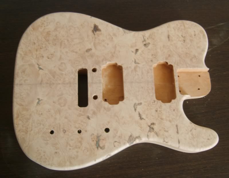

Burl maple tele body has gone off to the sprayers as well
the mahogany has some knots but it sounded too good to ignore!!
