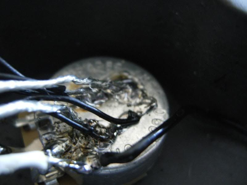

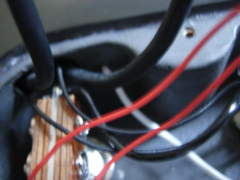

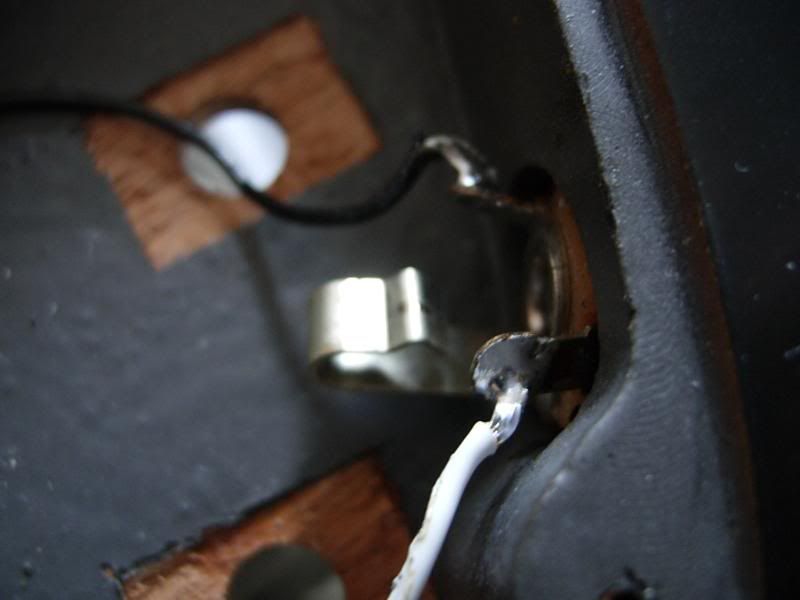

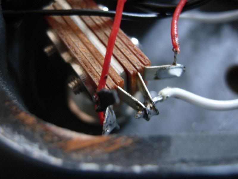

The avatar? Otherwise i dont get you, sorry  :?. Here comes the pics, the solder joints on the back of the pot are pretty bad and messy, so i will probably redo them.
Unless the solder joints are really bad and worsening the tone i dont know, the scheme seems right, but its really weird that the pot needs no contact with the guitar to sound..
