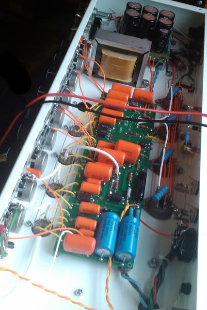

HEY!
so I built this and made a thread about it. In that thread I mentioned that it had some noise going on, but you couldn't really hear it on the clip. Anyway, here is a gut shot...
Here is some stuff I've tried to track down the problem...
Test: Removing FX loop, Line Out, and Bypassing/Removing V4
Result: No Change
Test: Pulling 12AX7s Starting with V1
Result: Noise Decreases and disappears when phase inverter is removed
Test: Using different power & preamp tubes
Result: No Change
Test: Grounding preamp at star
Results: No Change
Test: Grounding Preamp at Power PCB
Result: No Change
Test: Grounding Preamp at footswitch Jack (footswitch jack sleeve acts as ground for the switching supply)
Result: No Change
Test: Lifting Footswitch Jack from chassis ground
Result: Introduces some hum
Test: Grounding filament centre tap at star rather than potential divider (Elevated heaters where in from the start)
Result: No Change
Test: Grounding Output Jacks at the chassis
Result: No Change
Test: Moving wires using chopstick & replacing shielded wire
Result: No Change
Test: Altering position of Power PCB & Choke
Result: No Change
Test: Adding a 47uf/450V cap in parallel with C33 (part of the filtering)
Result: No Change
Test: Adding a 200uf/300V cap in parallel with each AC Mains filter cap (these work in pairs. Two before the standby switch and choke, and 1 pair after)
Result: No Change
Test: Pot case grounding at chassis improved
Result: No Change
Test:
1) re-wetting EVERY joint in the amp. Heated it and put a touch of solder to it. Inspected it. etc...
2) Removed unused components (PCB mounted FX Loop related parts)
3) Changed AC bridge rectifier diodes (not the bias diode) from UF5408 to some spare 1N4007's
4) Changed the power tube grid stops to 2.2K from 5.6K (as per my EL34 Avenger)
5) Tried using totally different tubes again.
Result: No Change. Still get the same noise. Changing diodes at this point didn't make a noticeable difference.
Test: Tried charging the caps up while playing and then continuing to play with the mains off and standby on.
Result: The hum did vanish from the output.
Any more ideas? It's Oscilloscope time, right?

Are the preamp heaters  AC? If so, try running them on a 5V DC supply. If the hum goes, it proves the heaters are the problem. (Looking at the way those rails are set up, I hope they are DC!)
It also might be an earth loop. Make sure each part of the amp is only grounded in one place (lift the ground and measure for an open circuit.)
The fact that the hum goes when you take the PI valve out shows its in the preamp.
The fact that the hum goes immediately you turn off the mains shows that it is coming from an AC source isolated by the mains switch.
Keep plugging away, you'll find it!  :)

RIGHT!
so, I figured out a way!
I got an Ipod wall wart charger, and butchered a USB cable, twisting together to data wires and leaving the power and ground separate.
The ipod charger kicks out 5VDC 1000mA.
I detatched the AC heater wires and taped the ends individually and pulled them out the way.
I plugged the USB cable into the charger after measured the voltage on my DMM, 5.4VDC.
Unplugged the USB cable, and wired the +5V red USB wire to pin 4&5 rail, and the ground to the pin 8 rail.
I only put in the phase inverter, which does have the noise present if in place by itself, but mainly because of the current draw from the heaters in the 12AX7's. I think all 4 12AX7's would overload the charger.
I plugged the USB back in and got GLOWING FILAMENTS!
I turned the amp on and got some hum, but different to the hum I had previously.
It was loud (I guess powering your preamp using a banged up USB cable and an ipod charger isn't so good)
When I turned the amp off BOTH mains and standby, I got some REALLY loud hum coming out the speakers.
probably not a good, or definitive test (I doubt the filtering on my ipod charger is very good) but it did alter the characteristics of the hum in some way.
and yes, I walk a fine line between genius and stupidity.

the grounding is a kind of mix of bus and star.
the power pcb has one point to ground that goes to the star.
the High Voltage centre tap is at the star
the PT ground is at the star
a rail that joins Pin 1 on all power tube sockets is at grounded at the star
(power Pin 8's are joined in pairs, then each pair to a 1K/3W resistor, then to the pin 1 rail via bias test points)
Pot Casings are grounded at the chassis. No bus on the back of the pots.
output jacks are grounded to the chassis, though both sleeves are wired together.
the OT secondary common is grounded at the output jacks.
the Footswitch jack is grounded at the chassis, this makes the ground for the switching supply.
The input jack is isolated from the chassis but the sleeve sits on the ground lug rail that runs across all the pots that have lugs going to ground. This rail is wired to the preamp PCB, which has a ground track running through its centre, at the other end of which this is joined to the star ground.
the only signal wires that go near the heaters are the depth and presence related wires. but moving them while the amp is on doesn't make any difference. In fact moving any wire while the amp is on makes no difference.
