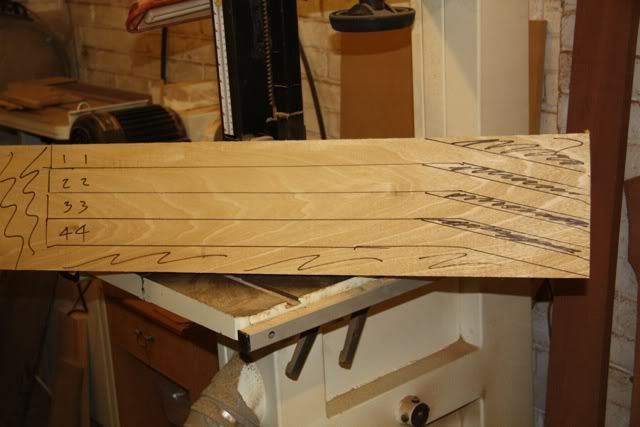

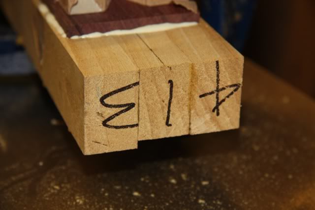

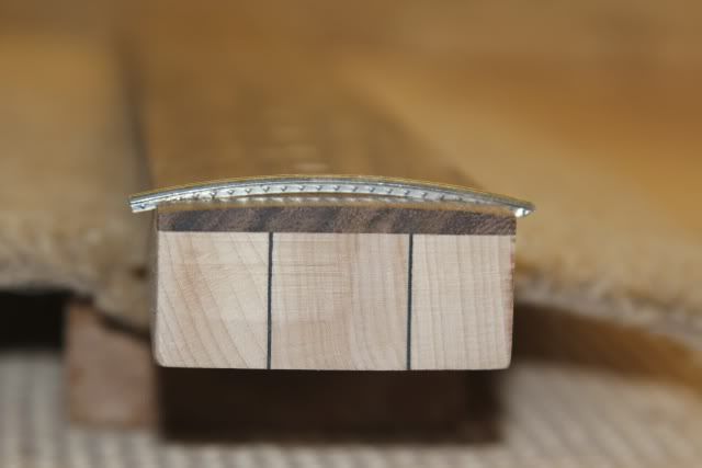

This is why we prefer to use quarter-sawn wood where the grain is as vertical as possible.
When we make tri-laminate necks it lets us take timber that is slab sawn and turn it around so it is quartersawn
See how the grain runs almost vertical

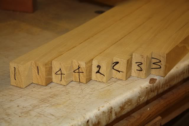

Here is the process we use for some necks
Cut out the 4 pieces from a thick-ish piece of timber that viewed from it's end would be slab sawn when laid flat

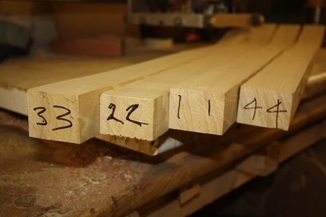

Once cut out you can see that the grain is vertical in the pieces we have cut
These are wide enough to be slit into 2 pieces each.
we select which ones will work best together for balance of stresses

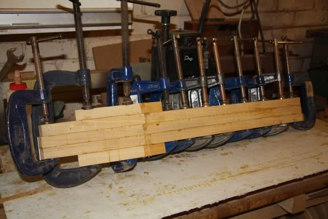

Time to glue them together
