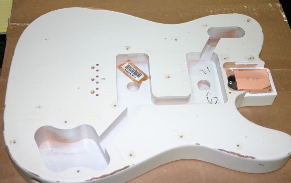

Remember the 72 Deluxe had WRHB pickups. If ordering the body and pickguard from Warmoth be sure to specify standard humbuckers for the routing!!! The WHRB are much bigger and the rout leaves very very little neck pocket left, less than .125!! A standard humbucker rout will leave more meat on the body up there. Also putting humbuckers in the scratch guard if it is cut for WRHB will require a mounting ring to cover up the huge hole.
It's not as thin as that!  I've had a Warmoth Tele Deluxe body, and a '72 Thinline, routed for the Wide Range humbuckers, and there's a perfectly reasonable amount of wood between the neck pocket and pickup cavity:

Yeah, the Warmoth Tele Deluxe pickup routs fit both Fender WR and Gibson/standard humbuckers by default, it's the pickguard that matters. I specified Gibson pickup routs on the pickguard, so we're good there. I also opted for a Fender American Standard flat mount bridge, which is 53mm, not 57mm. And the Warmoth Tele Deluxe body and CBS Strat neck both come standard as 4-bolt.

« Reply #13 on: October 04, 2012, 06:36:19 PM »
LOL, now I'll have to find a Fender body so you can see... obviously Warmoth leaves more material up there!!
I was setting the neck and that part of the body actual cracked out on me!!! Had to glue it up.

« Reply #14 on: October 04, 2012, 06:40:57 PM »
Aahhh... here we go. Fender uses the "dog bone" rout so that they don't have to tool change to a 1/4" dia tool when routing the body on the CNC, this confounds the problem, plus it looks like they also oversize the pup and control cavities to enable less than precise assembly:
