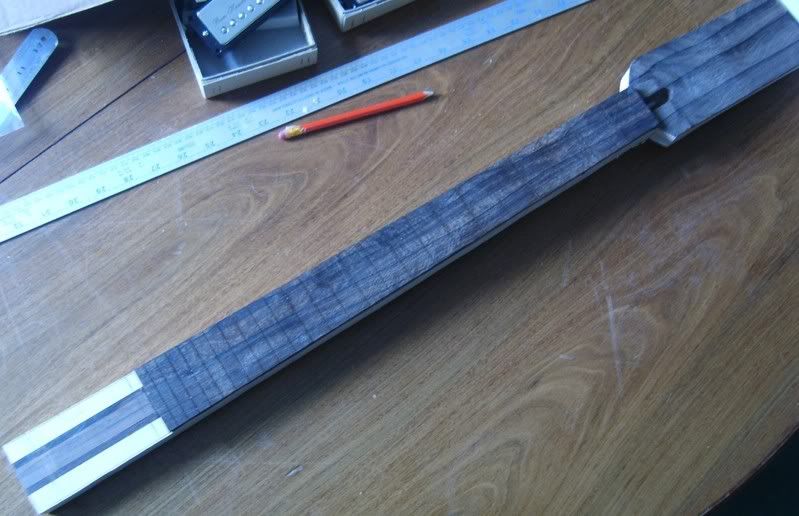

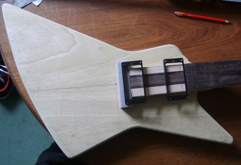

got the neck blank glued up for the explorer.
Its maple/wenge/walnut/wenge/maple with ziracote fretboard and headplate and a long tenon that will extend into the bridge pickups cavity for a super stable set-neck
like this
also just ordered a kahler trem for it, just trying things i havnt done before
