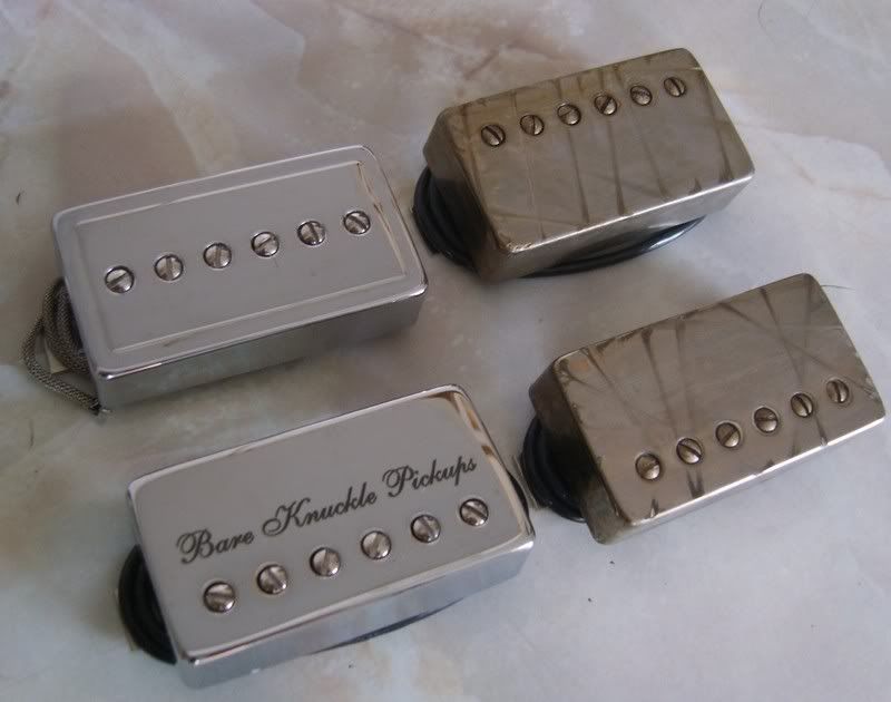

just had my next couple of BKP sets turn up including the ones for this guitar.  they look pretty good but unfortunately my camera's battery ran out after one photo so you will all have to wait a bit longer before pics

oh alright!!  here ya go:
along with a mule/manhattan set for something else!!

Oooh - They look very nice!
What are they in the end?
Wez venables guitar build - Done and dusted!!
« Reply #339 on: August 22, 2007, 11:57:08 AM »
miracle man (men!!) for this one.
Tim seems to have got just about the right amount of distressing.  I think this wartorn & aged nickel cover effect really works .  at first sight i thought they could do with a little more but the more i look at them the more i think they are perfect for the guitar

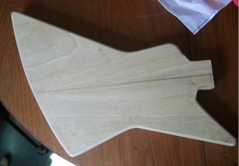

Anyway, strats out of my hands for a few weeks so i will post some of my other summer project thats just started
korina body again, this time no fancy top.  Its the explorer pro!
i have purposely left the neck join section a bit oversize because i want to experiment with something i havnt done before.  You may know that i have a dislike of Sg neck joins and explorers have a similar problem.  My plan to get round this is to use a wider and longer neck tenon.  The neck will hopefully extend all the way to the bridge pickup route.  but thats will be decided by my neck blank which is actually an offcut from this;
so the neck will have the same maple/wenge/walnut/wenge/maple laminations and you will see them on the face of the guitar going between the two pickups.  Well we will have to see if the neck blank is actually long enough for that first - if not i will probably end the neck between the two pickups, but will have to see if i think that will look right first... it can always ahve the traditional explorer scratchplate covering it !...... The point is the tenon will be longer than normal and that should increase stability and strength.

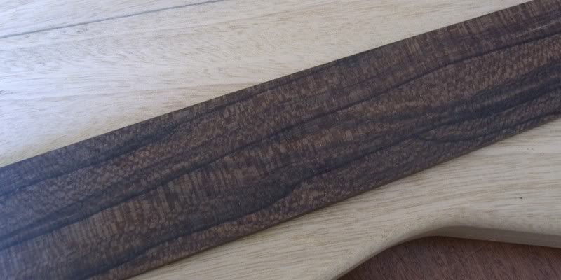

fretboard and headplate will be this quite speckly ziracote:
the finish will probably be a nice blood red colour
