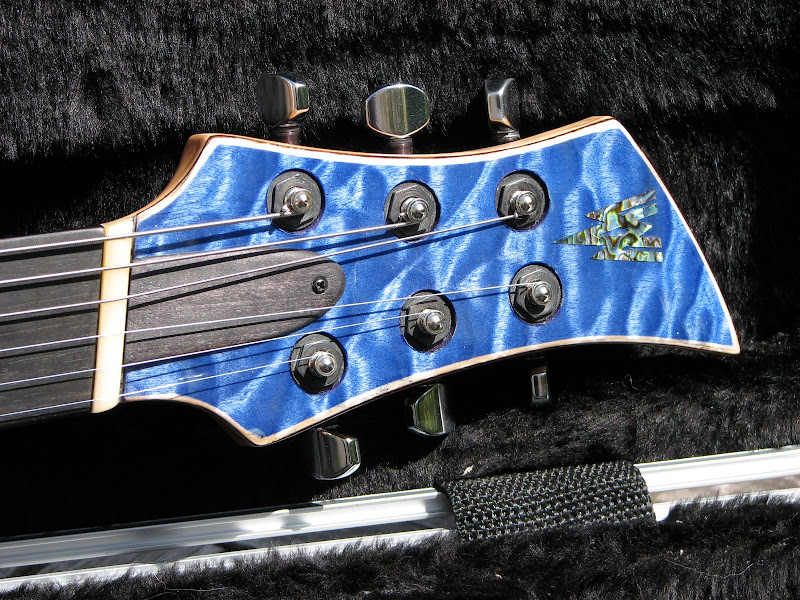

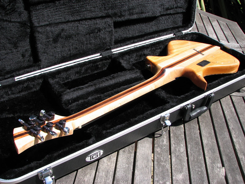

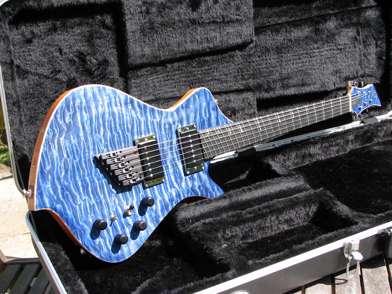

Here's some pics ...
After I'd been playing it for a couple of minutes, I seriously did have to check that I was playing a fanned fret guitar because it felt so natural and easy.  Now, I'm not a 50-note-per-second shredder, so it might differ for different styles, but for "normal" playing, this thing just feels completely comfortable.
The Crawler is totally excellent for vintage rock sounds through my JTM 60, the MQ is also a great sounding p'up, but I'd expected "more" for some reason.  The Graphtech Ghost piezo system produces some really nice warm acoustic sounds, and add an extra bit of clarity and bite when blended in with the other pickups.
I started this year with a plan to thin-out my collection of guitars - just because I realised that I had some that I wasn't playing often enough.  So far, I've sold 2 and taken one to pieces.  This Vendetta is the 6th addition though ... so the plan hasn't been too successful.
If I ever get permission to post in the "Seconds Out" forum, then expect to see some "for sale" postings from me over the next few weeks.  Does anyone know why I'd be blocked??

might just be worth having a play with the height on the MQ - small changes can make a big difference and i have had BKP's thats just jumped into life with half a turn
thx for the pics!
