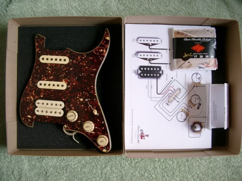

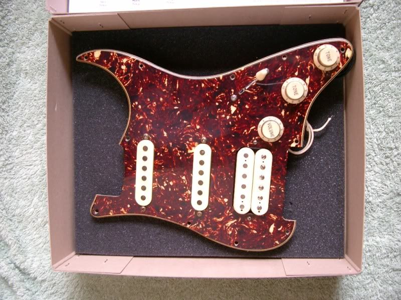

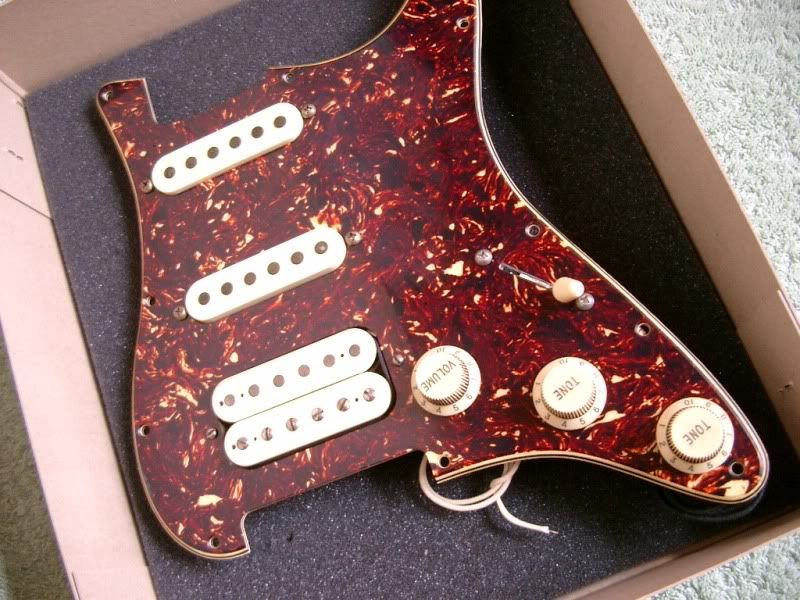

New Aged Pre-Wired Pickguard (Scratchplate) Day!
This arrived from BKP yesterday morning.
Anyone experiencing a touch of deja vu at this point may remember Nolly's thread about his Custom Shop Relic Strat:
https://bareknucklepickups.co.uk/forum/index.php?topic=25139.0
In my defence, I'm not a total copycat - it was always going to be aged cream on tortoise, and I was 95% decided on HSS rather than SSS.  But Nolly's thread certainly made me decide on a complete pre-wired setup from BKP (rather than buying separate bits), and also helped with the choice of pickups - I was going back and forth between some combination of Crawler, VHII, Abraxas, Mother's Milks, Irish Tours or Slow Hands.  Crawler was favourite for a long time, but in the end I've gone for.... Abraxas and a pair of Slow Hands.

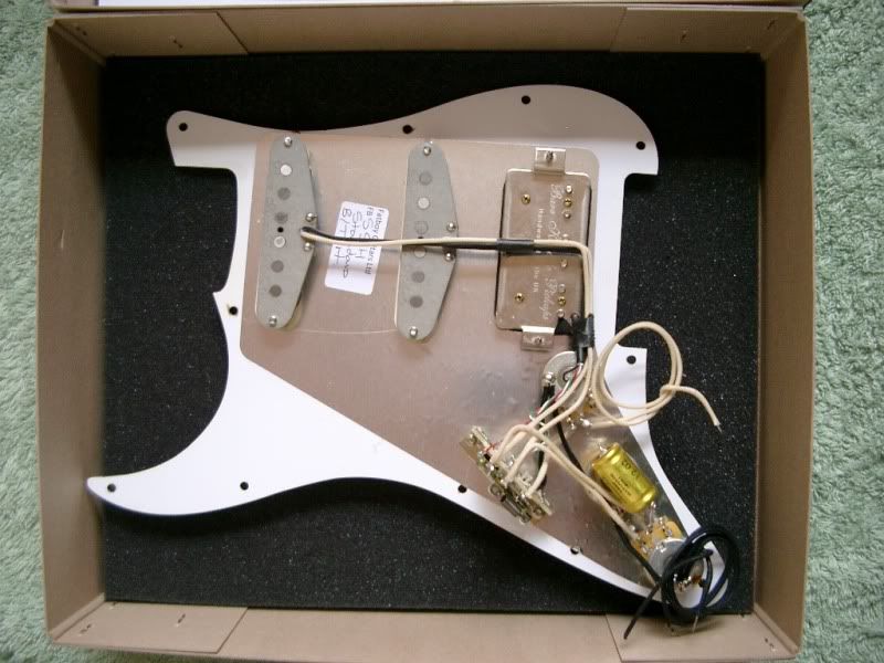

I wasn't sure about pot values - I was thinking about 250k rather than 500k because I really didn't want the single-coils too bright/harsh, or maybe 500k volume and 250k tones, but Tim suggested 300k for all three pots, which seemed a good compromise.  The cap is a Jensen/BKP 0.022.  Wiring is the "standard" HSS setup with a RW/RP middle pickup and the humbucker split in position 2.
It all looks great - excellent relic work all round and super-neat wiring.   :D
Now I suppose I need to get the thing put together at last....  :|

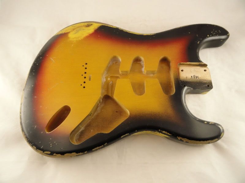

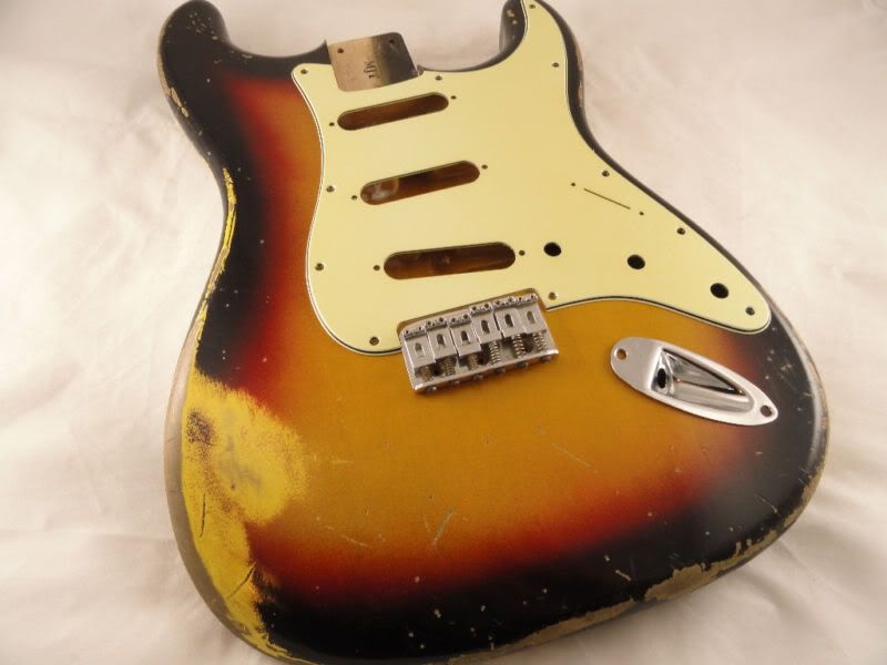

It's going in the section where I keep the bits for my relic hardtail Strat project  :P :

Should look rather tasty with that guitar body. What neck you having with it.  Maple or Rosewood?
Re: NAPWP(S)D! {BKP Content}
« Reply #7 on: March 18, 2012, 07:00:30 PM »
That looks like a great body Philly - are you going to rout it out yourself?

Yep.  I have a trusty humbucker routing template I made years ago, should do the trick!  I had to wait to actually get the scratchplate because the position of the humbucker varies quite a lot between different manufacturers.
It's a Fender neck with a rosewood board.  A certain Mr Venables has done a very nice relic job on it for me.  :)
I'm going for a mid-'60s pre-CBS look, but not trying to get all the details slavishly correct (for example my neck has a slab board when it should really be veneer to be period-accurate!)
